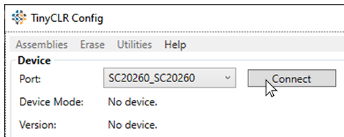

Connecting to a device​
When TinyCLR Config opens, the Device section is near the top of the window. Plug your device into USB, click the Select a device dropdown, pick your device from the list, then click Connect.

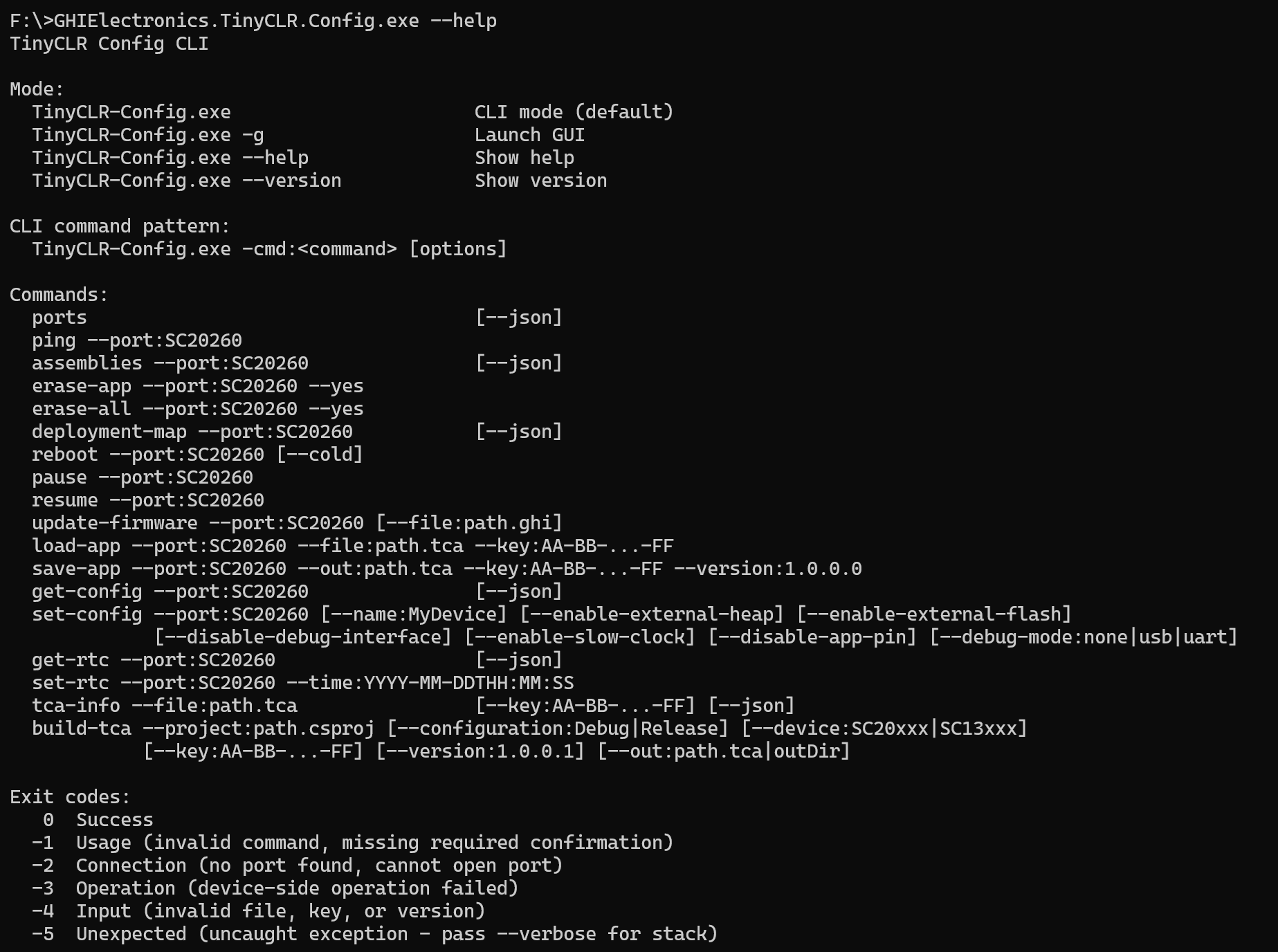

CLI mode​
The CLI is the default when the tool is run from a terminal: GHIElectronics.TinyCLR.Config.exe with no arguments starts CLI mode, while -g launches the GUI. It's built for scripted and headless workflows — build servers, CI, and production lines — and it exposes a few operations the GUI doesn't.
TinyCLR Config CLI help
Commands​
Every command follows the same pattern:
GHIElectronics.TinyCLR.Config.exe -cmd:<command> [options]
Run GHIElectronics.TinyCLR.Config.exe --help for the full list, or --version for the version. Common commands:
CommandWhat it does
-cmd:portsList connected devices and ports (add --json for machine-readable output)
-cmd:ping --port:SC20260Verify a device is responding
-cmd:assemblies --port:SC20260List the assemblies installed on the device
-cmd:deployment-map --port:SC20260Show how flash is used (the deployment map)
-cmd:erase-app --port:SC20260 --yesErase the application (erase-all erases firmware + app)
-cmd:update-firmware --port:SC20260 --file:firmware.ghiFlash firmware
-cmd:load-app --port:SC20260 --file:app.tca --key:AA-BB-…-FFInstall an encrypted .tca
-cmd:save-app --port:SC20260 --out:app.tca --key:AA-BB-…-FF --version:1.0.0.0Read the installed app back out as an encrypted .tca
-cmd:get-config --port:SC20260 / -cmd:set-config …Read or change device configuration
-cmd:reboot --port:SC20260 [--cold]Restart the device
