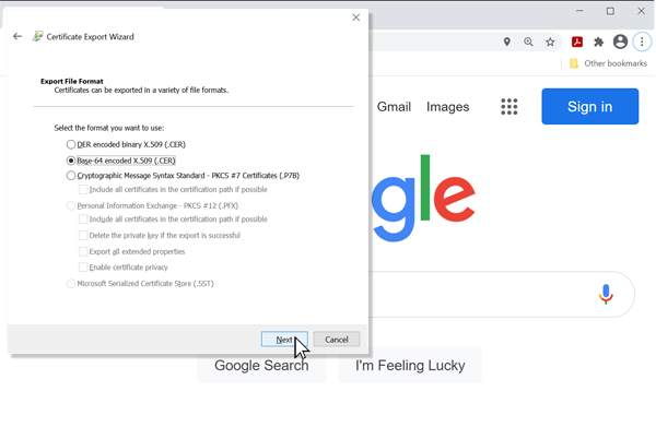

From a browser​
If you'd rather click than type:

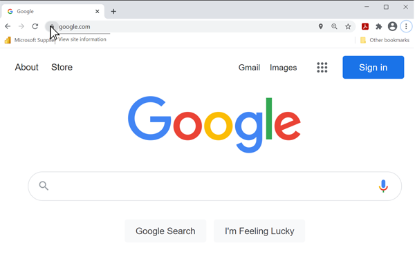

  1. Browse to the target site in Chrome or Edge.
  2. Click the 🔒 lock icon in the address bar → Connection is secure → Certificate is valid.

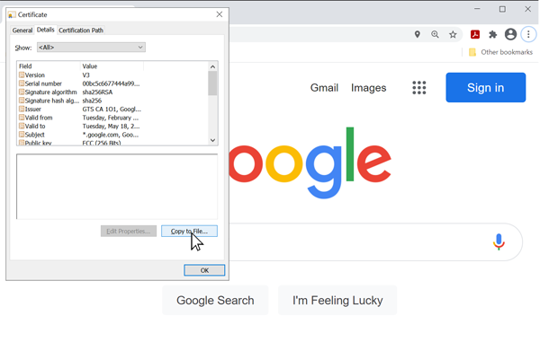

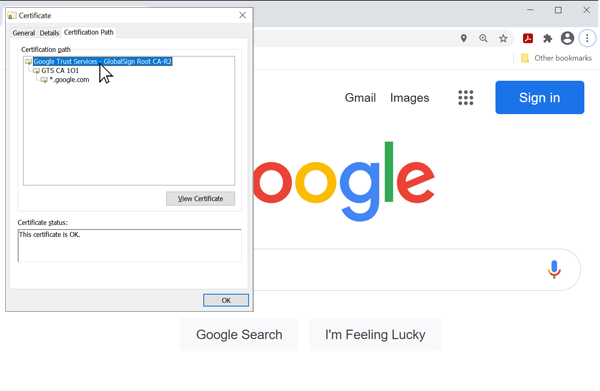

  3. Switch to the Certification Path (or Details) tab and select the root certificate at the top of the chain.

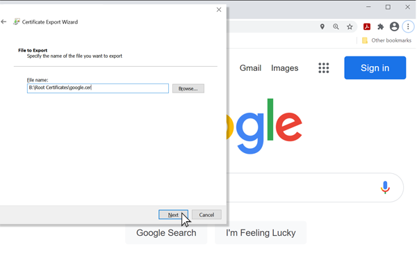

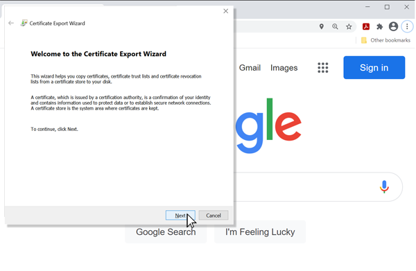

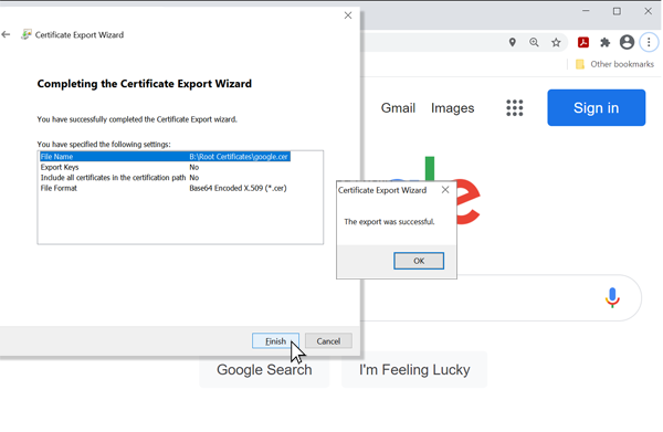

  4. Copy to File… → choose Base-64 encoded X.509 (.CER) and save.
Then add the resulting .cer file as a project resource and reference it from Resources.BinaryResources.<your-cert-name>.
