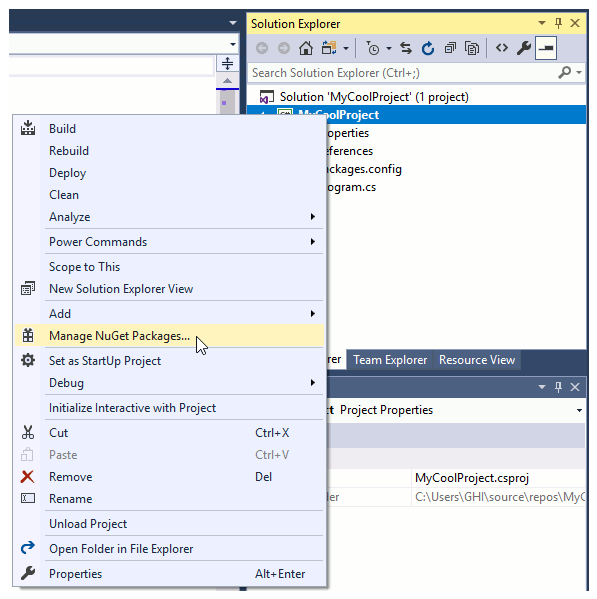

  2. Right click on your Project in the Solution Explorer panel and select Manage NuGet Packages. If the Solution Explorer window is not visible, open it by selecting Solution Explorer in the View menu. You can also select Manage NuGet Packages... in the Project menu of Visual Studio. View Show Solution Explorer

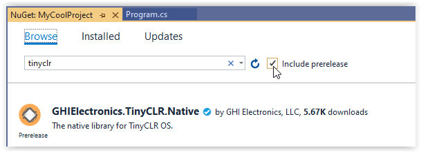

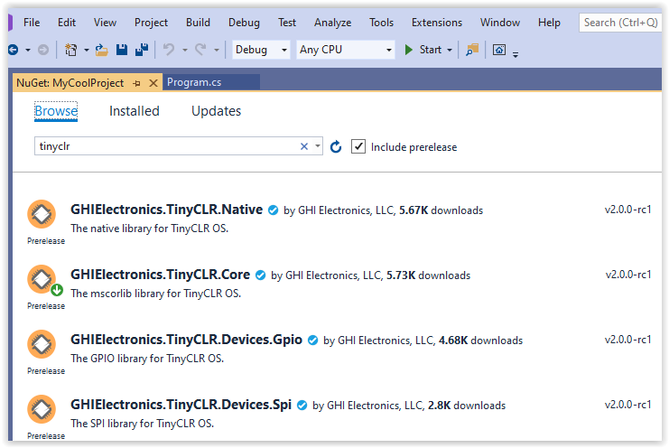

  1. In the search box type "tinyclr." You may have to check the "Include prerelease" box to find the libraries. Search for TinyCLR

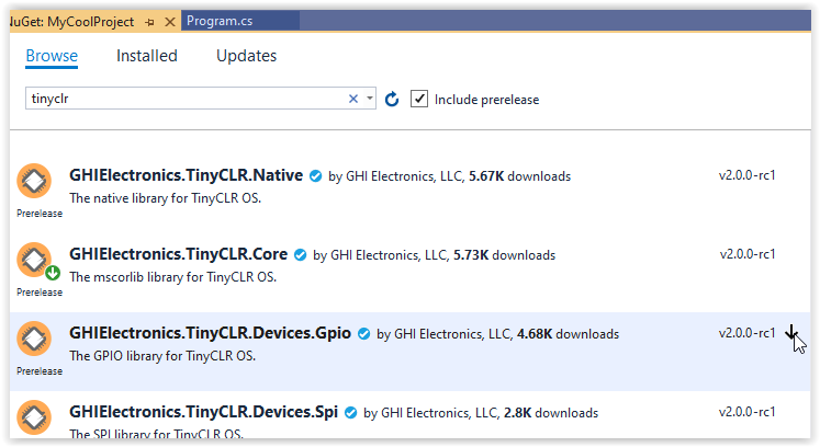

  2. Selecting the Browse tab will show all the TinyCLR NuGet packages. Browse NuGet Feed

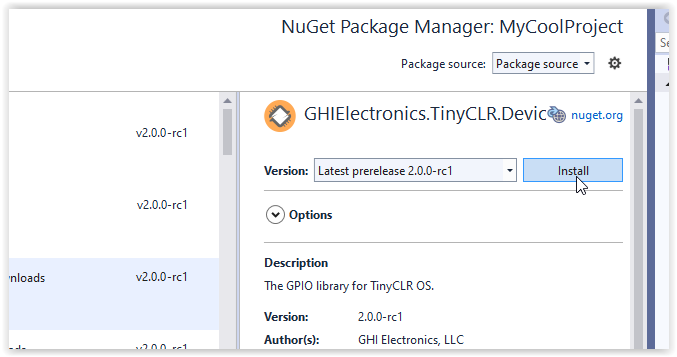

  3. To install one of the packages click on the down arrow to the right of the package version. Add Nuget Package
You can also select the package and click on the Install button in the center panel. Nuget-package-install-button

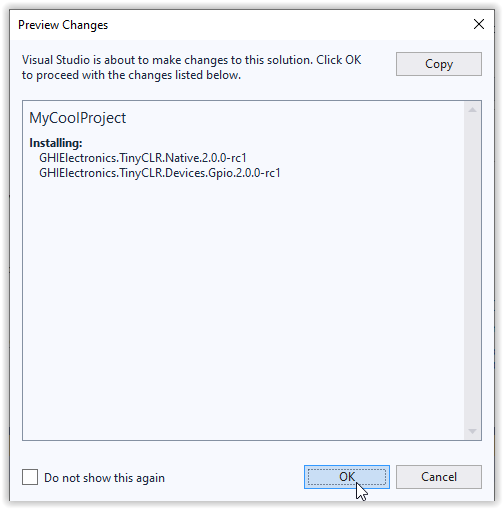

  1. Click OK to accept the proposed changes.
Accept changes

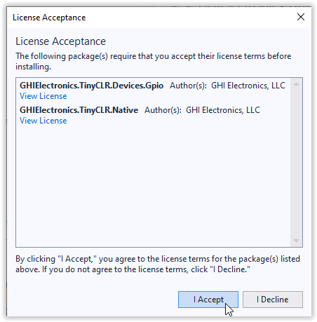

  1. Accept the licensing agreement to install the package.
Accept Agreement for NuGet
