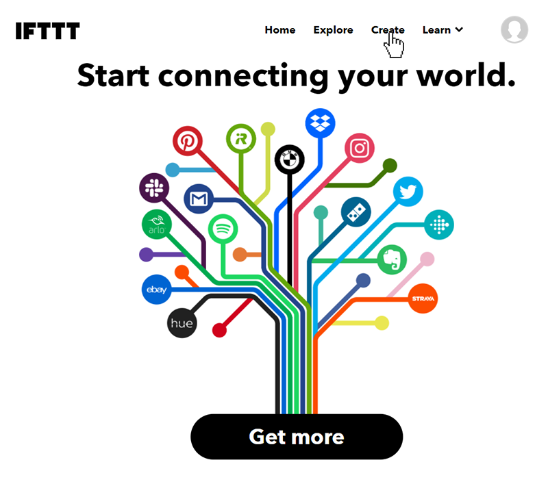

  1. An IFTTT account. Sign up at ifttt.com. The free tier allows a limited number of applets; IFTTT Pro lifts the cap. Verify current limits in their pricing page.

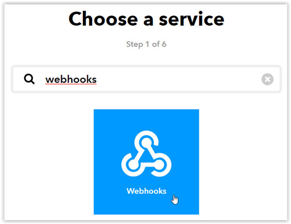

  2. Connect the Webhooks service to your account.

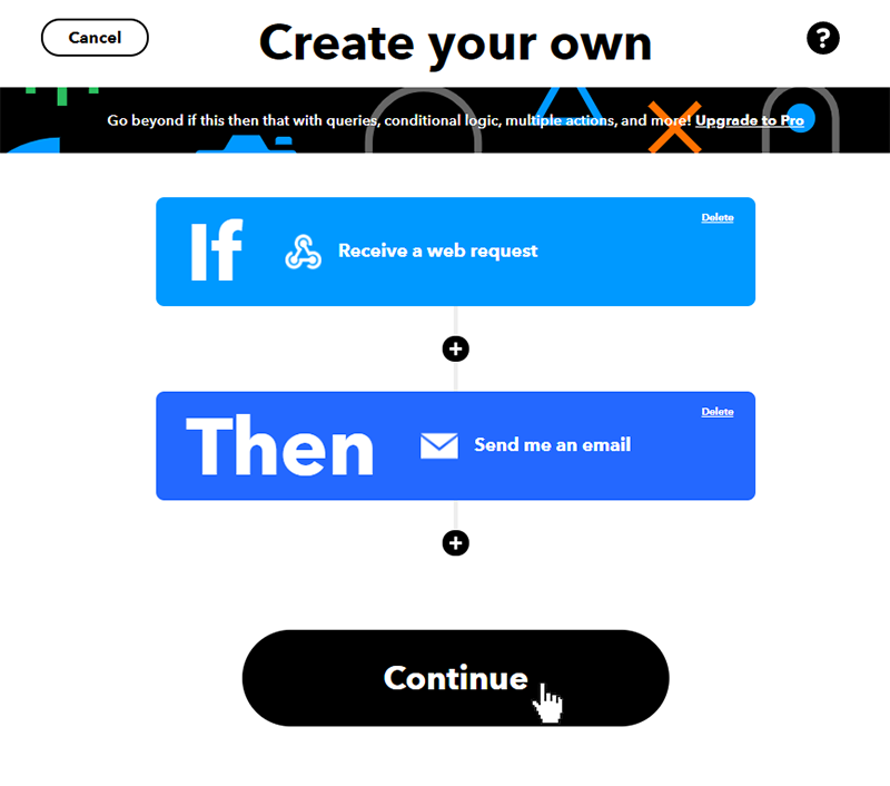

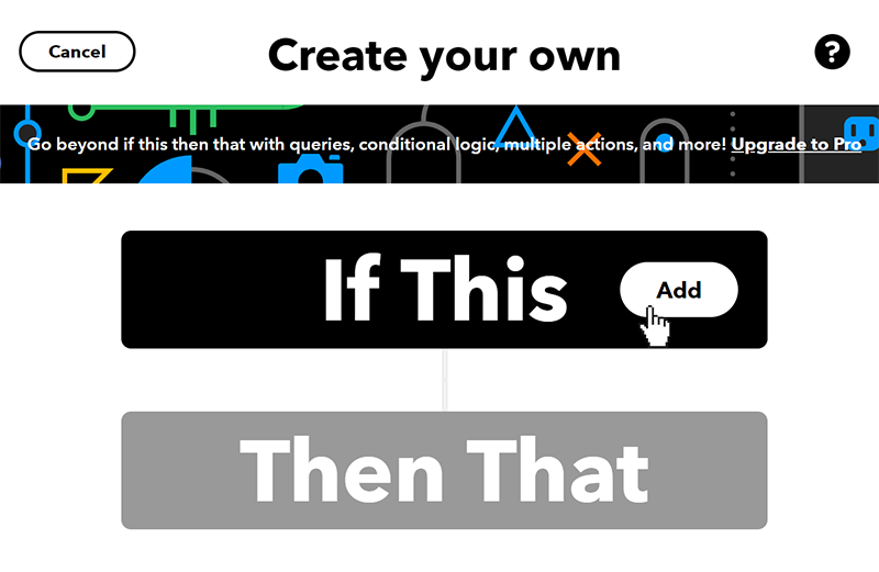

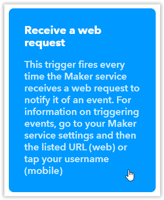

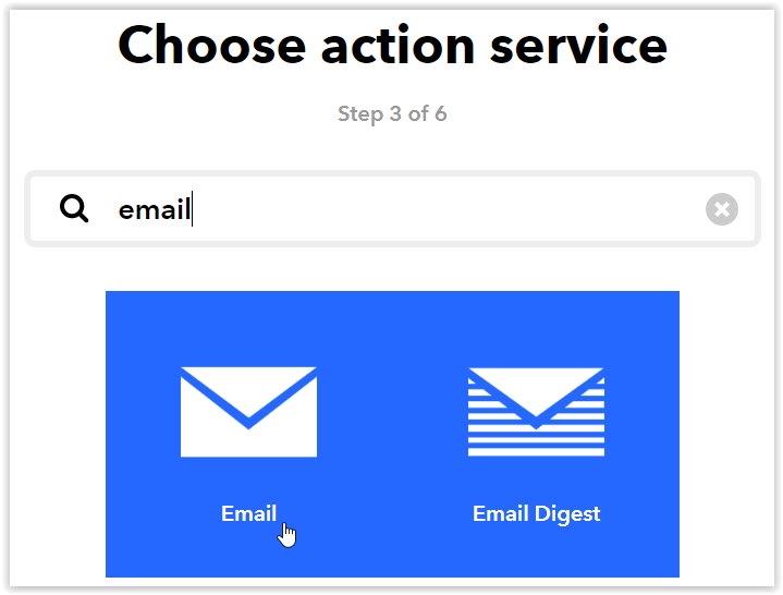

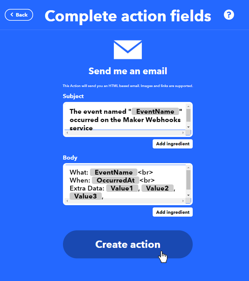

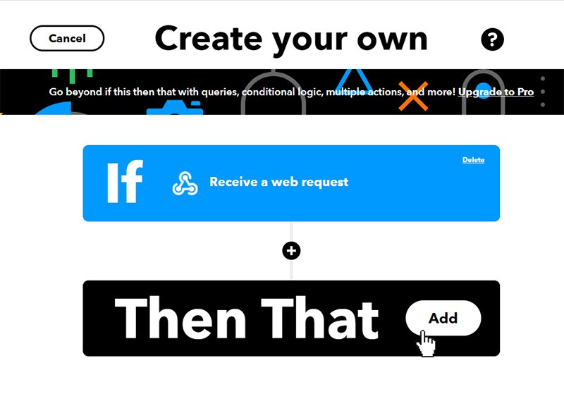

  3. Create an applet with the Webhooks "Receive a web request" trigger and pick whatever action service you want (email, SMS, Slack, smart-home, etc.).

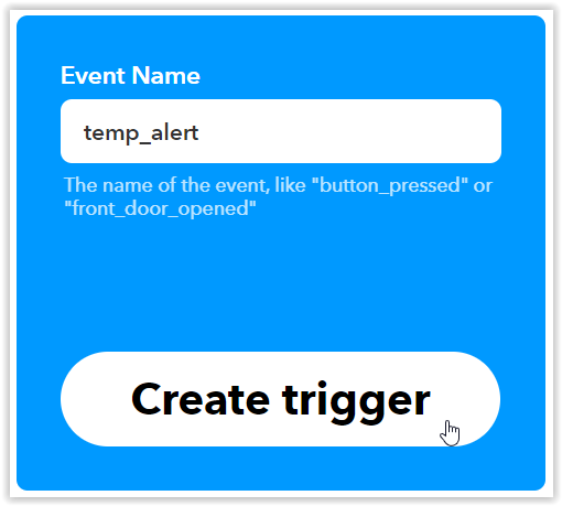

  4. Pick an event name — for example, button_press. You'll send this as part of the URL.

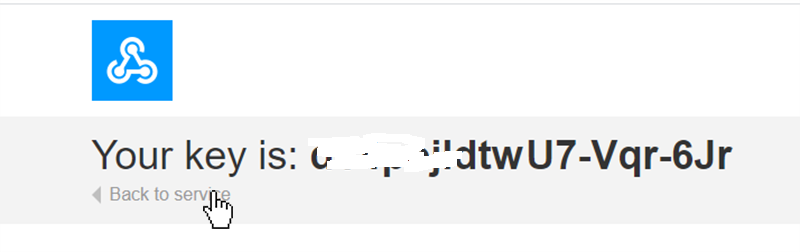

  5. Get your Webhooks key. On the Webhooks service page, click Documentation — your unique key is shown there, along with the URL format.

IFTTT lets your trigger carry up to three values (value1, value2, value3) that the action service can reference (for example, putting the temperature in the email body). Append them as query parameters or send them as a JSON POST body.
