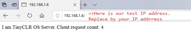

Point a browser on the same network at the device's IP — for example, http://192.168.1.6/:
Server response in a web browser
