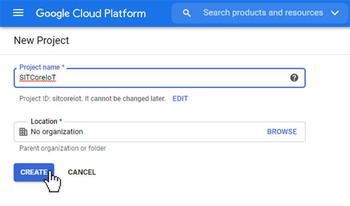

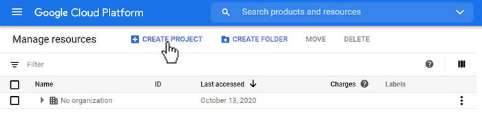

Let's create a new project. Click on 'Create Project' on the Manage resources dashboard.
GCloud Create Project
Next we'll need to create a meaningful name, for this project will call it SITCoreIoT.
GCloud Name Project

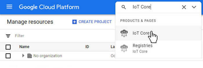

In the search box type 'IoT Core' and then select it.
GCloud Search IoT Core

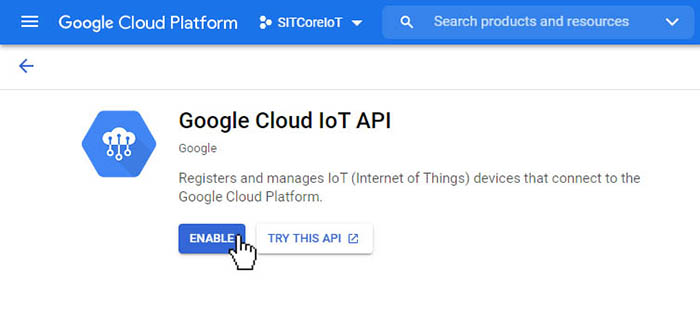

Next, we need to 'ENABLE' the Google Cloud IoT API.
GCloud Enable API

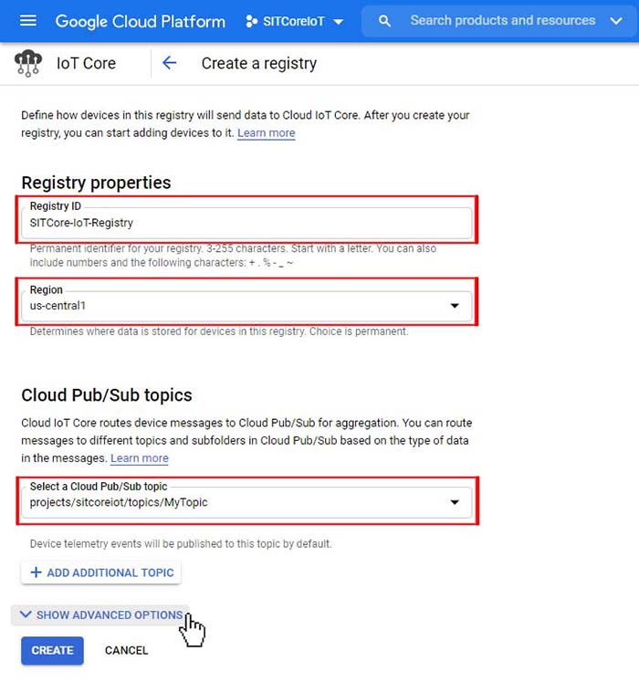

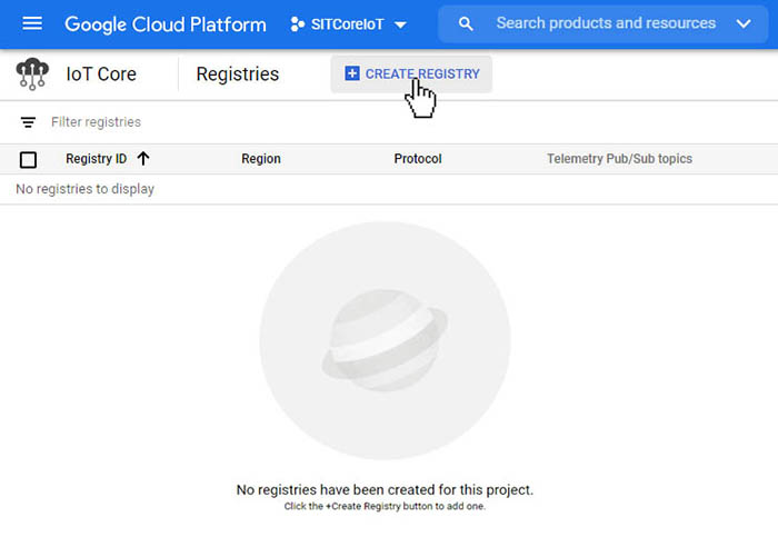

Next we'll need to create a Registry for our project. Click on 'CREATE REGISTRY'
GCloud Create Registry

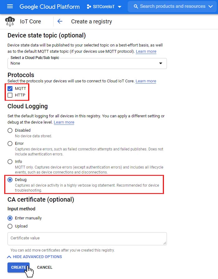

We need to create a 'Registry ID', select a cloud 'Region', and a create a 'Topic'. Finally, we need to click on the 'SHOW ADVANCED OPTIONS' Tab to finish the creation
GCloud Name Registry
For this exercise we only need MQTT, and we've selected 'Debug' under Cloud Logging. This isn't necessary but will allow us to see device activity in the log and may be useful for more complex programs. Finally click the 'CREATE' button.
GCloud Set Protocols

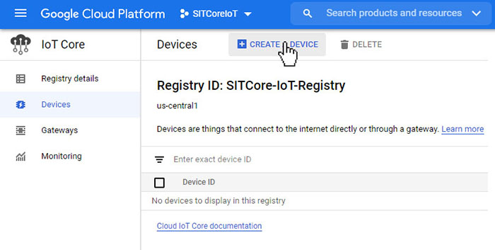

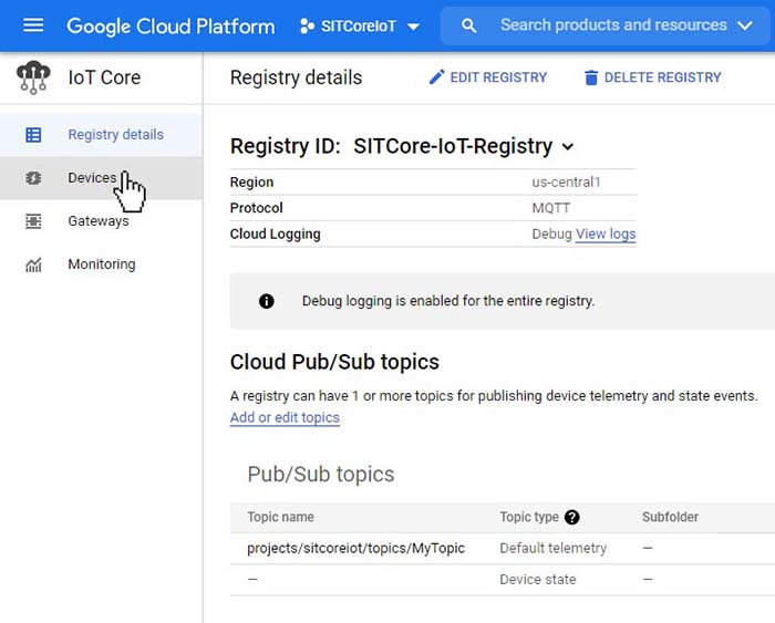

Once created we're taken to the Registry details dashboard. We need to create our device by clicking on 'Devices' from the left menu.
GCloud Create Device
From the Device dashboard, click on 'CREATE A DEVICE'

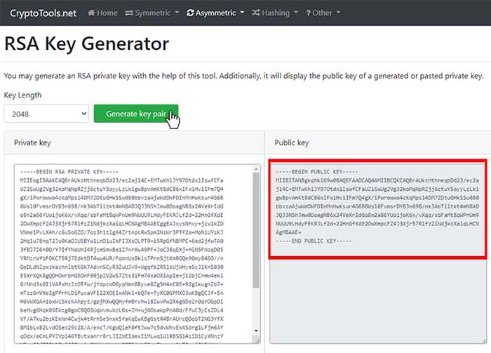

Before we continue, we'll need to generate both a Private and Public key that we can attach to our Device. This can be done with a program like OpenSSL (secure), or we can use a third-party site to generate one for us for testing (unsecure). For this exercise, we'll use a third-party site like:
CryptoTool.net
We need to select a Key Length of 2048, and then click 'Generate key pair'. Next, we need to copy the Public Key to the clipboard and use it in a moment. Keep the window open, we'll need to use the Private key later.
GCloud RSA Key

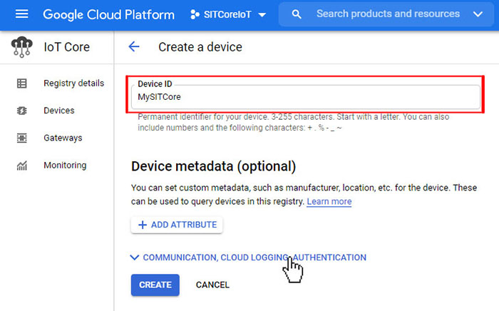

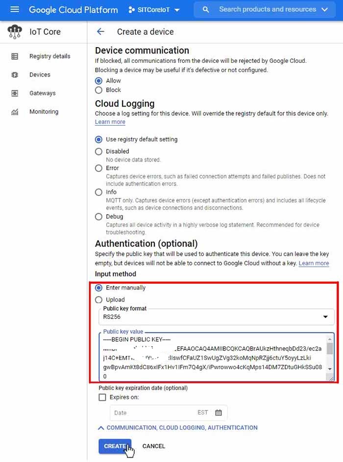

Now let's go back to the 'Create a device' dashboard in Google. We need to create a name for our Device, this will be the 'Device ID'. Before we click 'CREATE' we need to click on the 'COMMUNICATION, CLOUD LOGGING, AUTENTICATION drop down.
GCloud Create Device ID
Here we'll paste the Public key we generated earlier. Make sure the Public key format is set to RS256. Then click on 'CREATE' button.
GCloud Paste Public Key

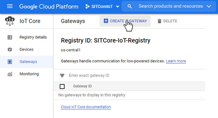

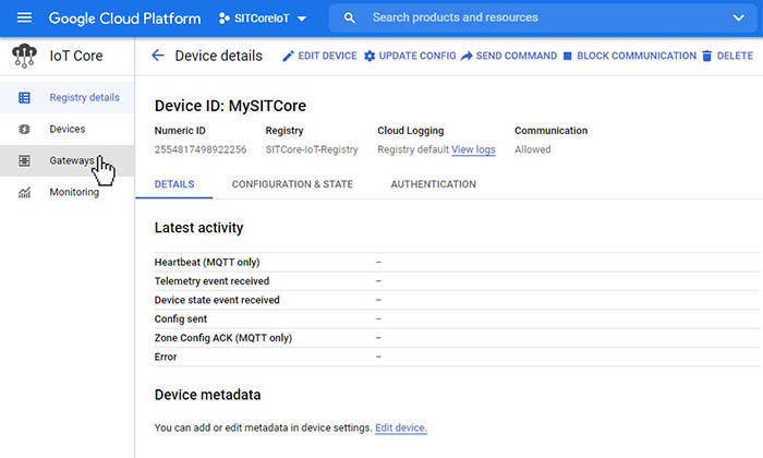

Next we'll create a Gateway. From inside the Device details dashboard select 'Gateways' from the menu on the left.
GCloud Select Gateway
Click on the 'CREATE A GATEWAY'
GCloud Create Gateway

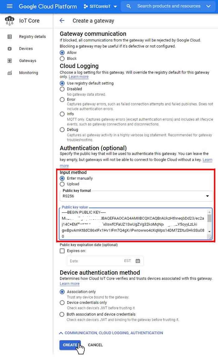

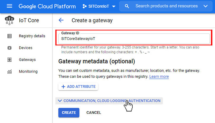

Next will name our Gateway, this will be the 'Gateway ID' that we will add to our code. Before we click 'CREATE', click on the 'COMMUNICATION, CLOUD LOGGING, AUTHENTICATION tab.
GCloud Name Gateway
We have to add the same Public key we pasted earlier here too. Make sure that the key format is also set to RS256. Then click on 'CREATE' button.
GCloud Gateway RSA

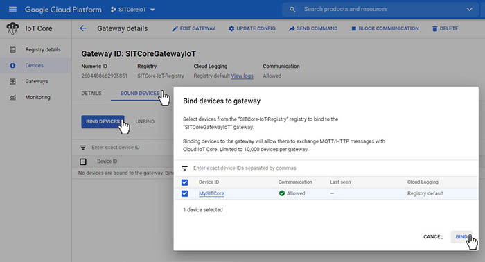

Finally, lets bind our Device to the Gateway. Click on 'BOUND DEVICES' tab and then click on the 'BIND DEVICES' button. Select our Device from the list and click 'BIND'
GCloud Bind Device

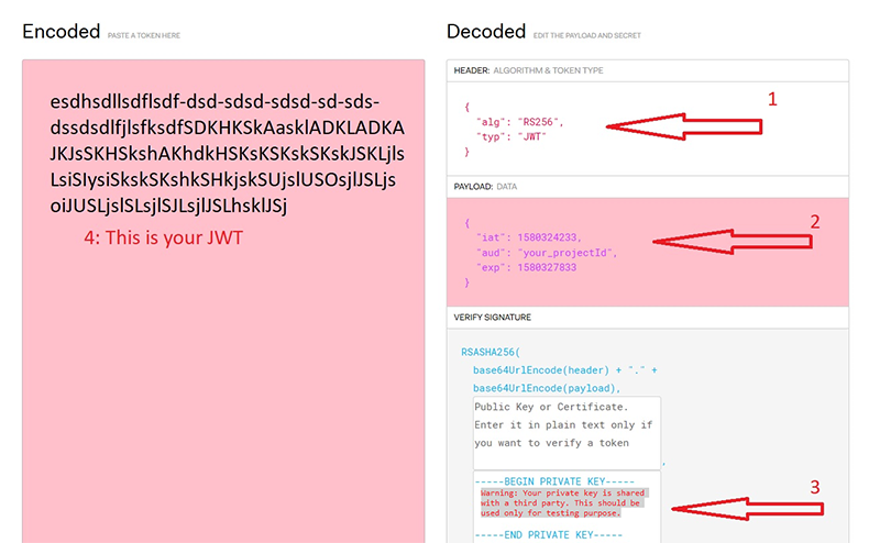

Lastly when connect to google cloud, you also need a JWT (JSON Web Token) to be used as password if using MQTT.
For an easy way to generate a JWT visit https://jwt.io/. However, if you are concerned about sharing your private key with a third party site, there are a multitude of other options.
warning
By using https://jwt.io/, your private key is shared with a third-party. This should be used only for testing purpose."
How to download generate JWT
We must change the 'PAYLOAD DATA' to match the image above. There are two fields iat (issue at), and exp (expire), they contain time in Unix Timestamp format.
You can convert them online at https://www.epochconverter.com/
"iat": 1602616824,
"aud": "sitcoreiot",
"exp": 1602616858
Finally copy your Endoded Token into this line of code in your program:
var jwt = "Paste your JWT here";
note
The google cloud connection accepts a maximum expire time of 24 hours, meaning the timespan between iat and exp must be less than 24 hours.

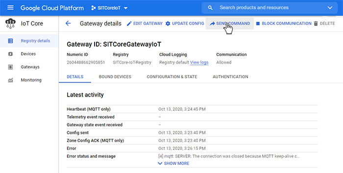

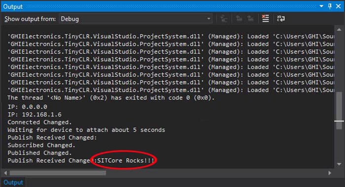

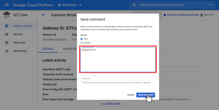

To receive a message from Google Cloud click on the 'SEND COMMAND' under the Gateway dashboard.
GCloud Message in VS
Enter your message and click 'SEND'
GCloud Create Message
The device will receive your message and display it in the Output window of Visual Studio.

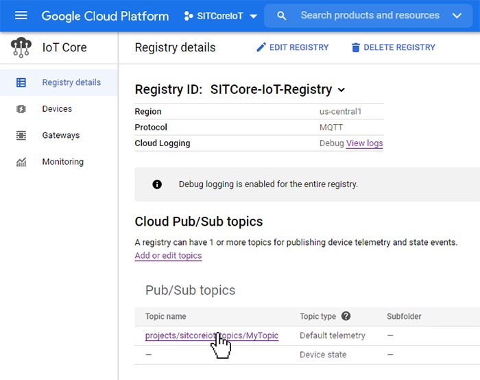

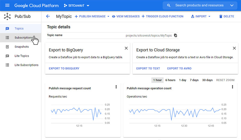

To view the messages being sent from the device to the cloud we need to add a subscription to 'MyTopic'. To do this we need to go to the Registry dashboard and click on the topic we created called 'MyTopic'
GCloud Send Message to Cloud

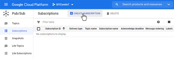

Once on the 'Pub/Sub' dashboard, select 'Subscriptions' from the side menu.
GCloud Select Subscriptions
Next, click on 'CREATE SUBSCRIPTION'
GCloud Create Subscription

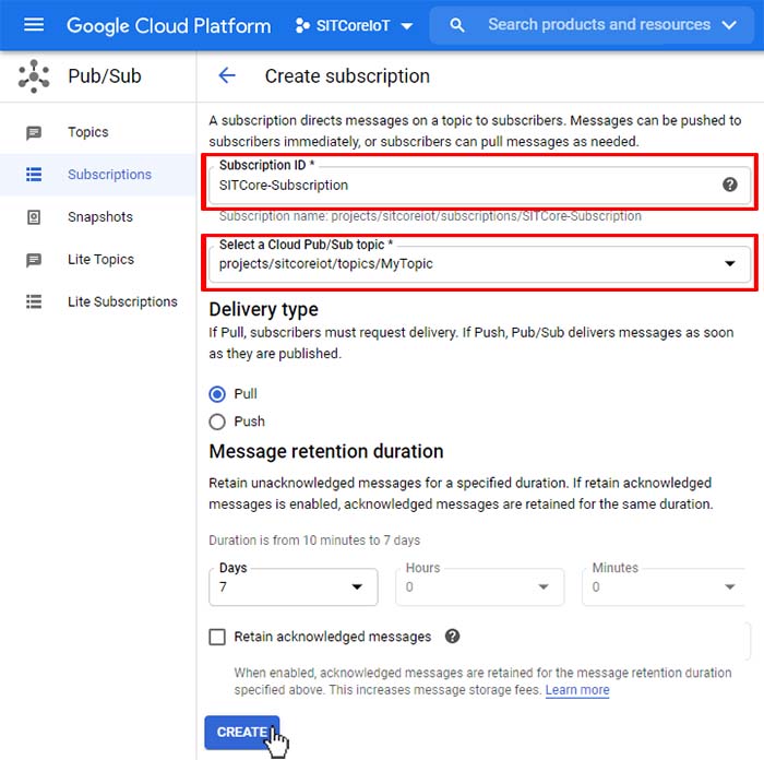

Create a name for in the 'Subscription ID' box and select topic we created earlier. There may be additional setting on this dashboard you can use, but for this tutorial we only need to set these two items. Click the 'CREATE' button at the bottom.
GCloud Name Subscription

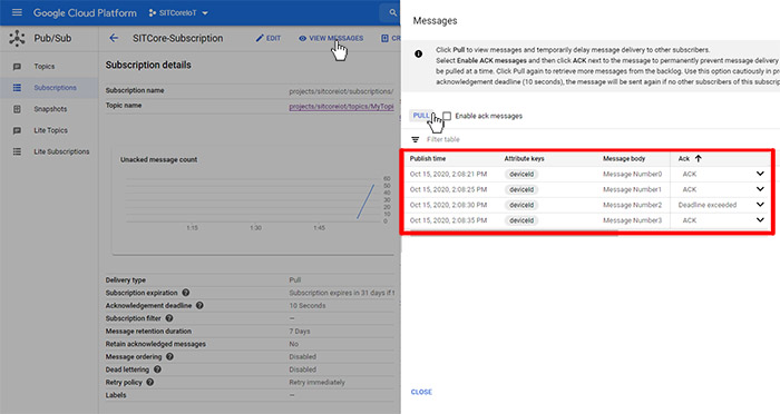

Deploy the program to your device. Once connected, inside the 'Subscription details' dashboard, click on 'VIEW MESSAGES', inside the 'Messages' Pop-up click on the 'PULL' button. This will display the latest messages being sent from the device. The tutorial program sends a new message every 5 seconds and then increments the count by one. We can also continue to send messages to the device from the 'Gateway' dashboard as we did earlier.
