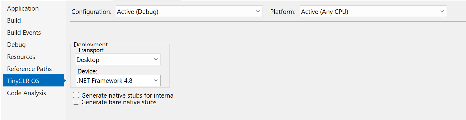

Switching to Desktop mode
Open the project's Properties → TinyCLR OS tab, and under Deployment set:
  • Transport: Desktop
  • Device: .NET Framework 4.8
TinyCLR OS project properties — Transport set to Desktop, Device .NET Framework 4.8
Press F5 to run on the PC. To return to the board, change Transport back to a device connection (USB/serial) and deploy as usual.
