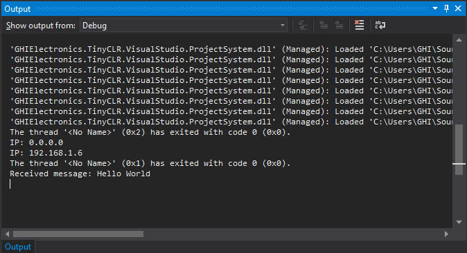

Messages sent from the Azure side land in PublishReceivedChanged:
Visual Studio output window showing received message
