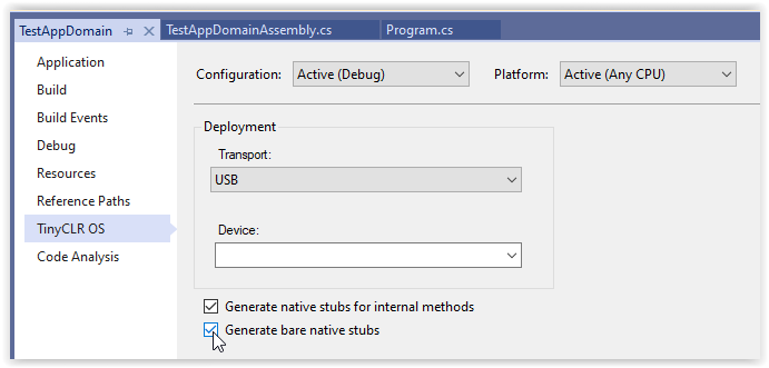

Build settings for the library​
Right-click the TestAppDomain project in Solution Explorer, choose Properties, click TinyCLR in the left panel, and check both:
  • Generate native stubs for internal methods
  • Generate bare native stubs
These options tell Visual Studio to produce the Portable Executable (.pe) file that the main app loads at runtime.
