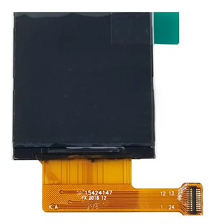

ST7735​
ST7735
An SPI color display controller, typically 160×128 pixels.
NuGet package: GHIElectronics.TinyCLR.Drivers.Sitronix.ST7735.

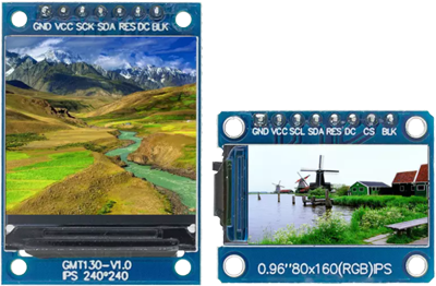

ST7789​
ST7789
An SPI color display controller, typically 240×240 pixels.
NuGet package: GHIElectronics.TinyCLR.Drivers.Sitronix.ST7789.

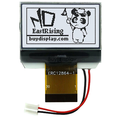

ERC12864​
ERC12864
An SPI-based monochrome display controller, typically 128×64 pixels.
NuGet package: GHIElectronics.TinyCLR.Drivers.EastRising.ERC12864.

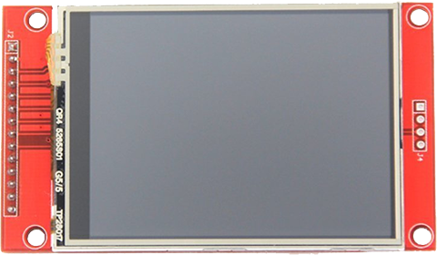

ILI9341​
ILI9341
An SPI color display controller, typically 320×240 pixels.
NuGet package: GHIElectronics.TinyCLR.Drivers.HiLetgo.ILI9341.

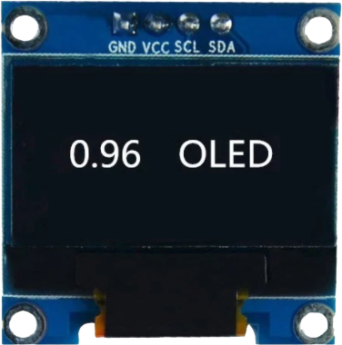

SSD1306​
SSD1306
An I²C monochrome OLED display controller, typically 128×64 pixels.
NuGet package: GHIElectronics.TinyCLR.Drivers.SolomonSystech.SSD1306.
