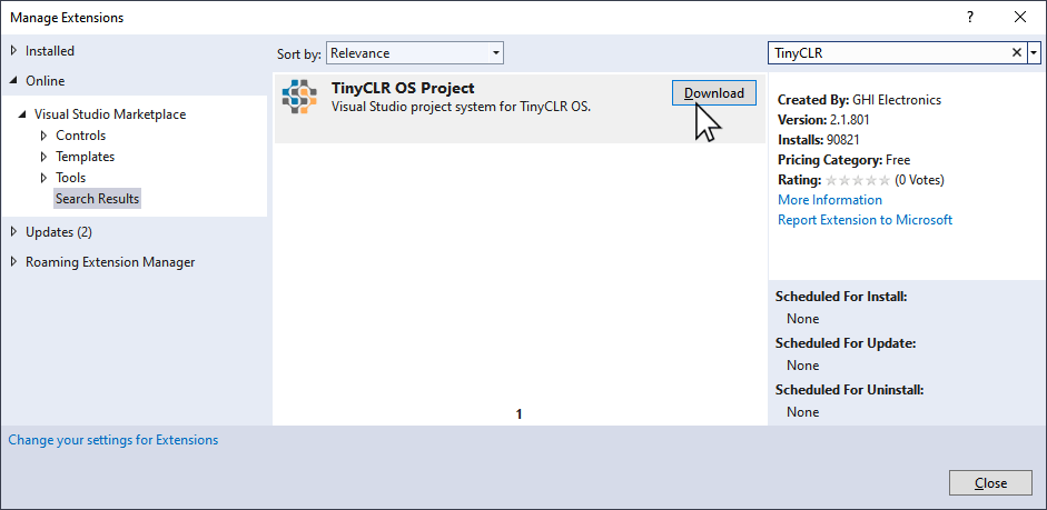

Install the TinyCLR Project System extension. In Visual Studio, go to
Extensions→Manage Extensions.... Search fortinyclr, and install TinyCLR OS Project. Restart Visual Studio to finish installation. -

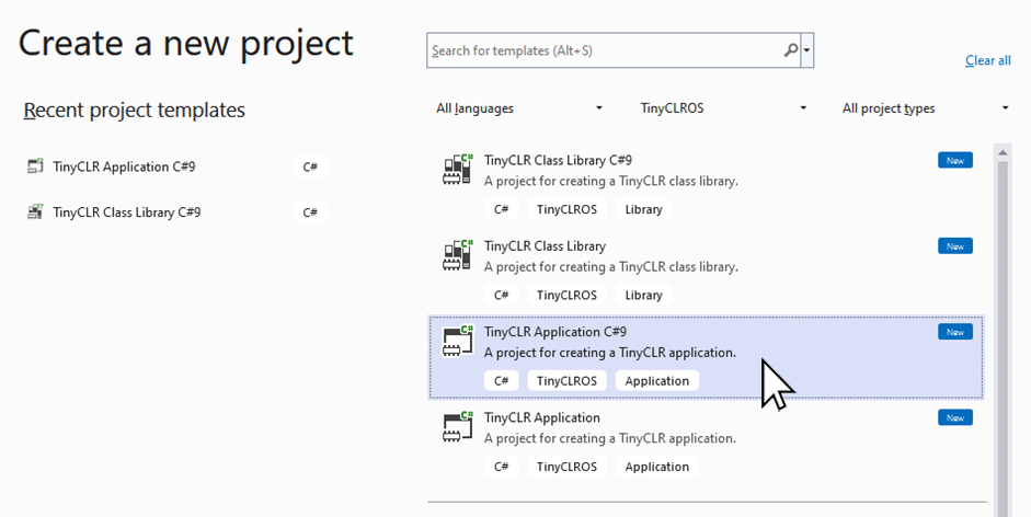

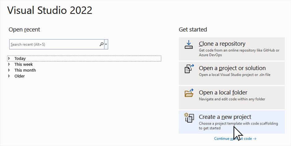

Open Visual Studio and select Create a new project.

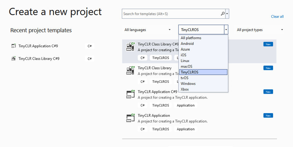

In the Create a new project window, pick TinyCLROS from the Platforms dropdown.
Pick the TinyCLR Application template, then click Next.

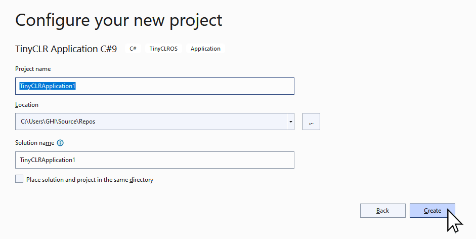

Give the project a name and select a location, then click Create.

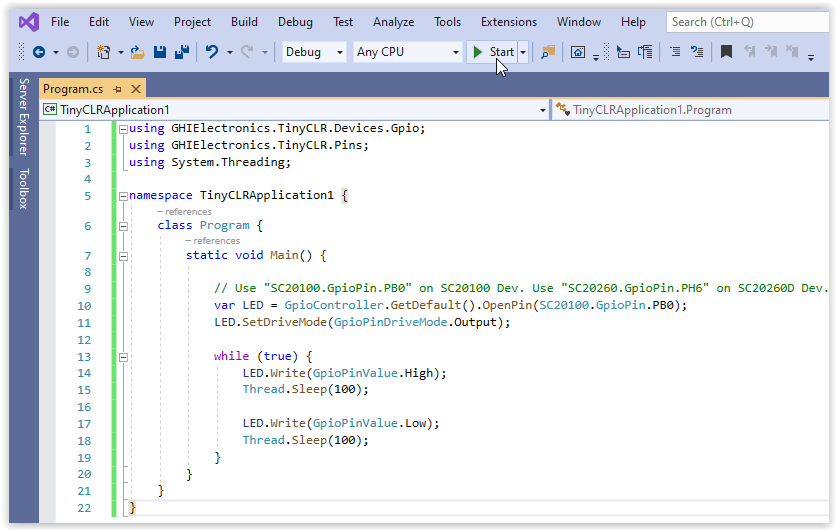

Plug your board into USB and hit Start (or press F5). Visual Studio compiles, finds your device, and deploys. (Need to pick the device manually? Use
Project→Properties.) The template's starter code prints an incrementing counter to the Output window — confirming that your dev machine and the SITCore board are talking. Stop the program when you're satisfied.

Install the
GHIElectronics.TinyCLR.Devices.GpioandGHIElectronics.TinyCLR.PinsNuGet packages. -
Replace
Program.cswith the code below. TinyCLR offers two GPIO APIs, and both ship in that one package — pick either tab, they do the same thing:
- .NET IoT API
- TinyCLR API
using System.Device.Gpio;
using System.Threading;
using GHIElectronics.TinyCLR.Pins;
// Adjust the pin for your board. For example:
// SCM13048Q Dev Board: SC13048.GpioPin.PA8
// SC20100S Dev Board: SC20100.GpioPin.PE11
// SCM20260D Dev Board: SC20260.GpioPin.PB0
using GpioController controller = new GpioController();
controller.OpenPin(FEZFlea.GpioPin.Led, PinMode.Output);
while (true) {
controller.Write(FEZFlea.GpioPin.Led, PinValue.High);
Thread.Sleep(100);
controller.Write(FEZFlea.GpioPin.Led, PinValue.Low);
Thread.Sleep(100);
Microsoft's standard System.Device.Gpio — the same API you'd write against .NET IoT on a Raspberry Pi.
using GHIElectronics.TinyCLR.Devices.Gpio;
var led = GpioController.GetDefault().OpenPin(FEZFlea.GpioPin.Led);
led.SetDriveMode(GpioPinDriveMode.Output);
while (true) {
led.Write(GpioPinValue.High);
Thread.Sleep(100);
led.Write(GpioPinValue.Low);
Thread.Sleep(100);
TinyCLR's original API, unchanged from v2 — existing projects keep working as they are.
- Press F5 again. The on-board LED starts blinking.
Both APIs work on the same hardware, and you can mix them in one application. GPIO covers the choice; the Electronics Lab lessons use the .NET IoT one throughout.
